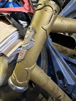

Hi,

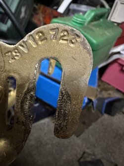

Possibly looking at doing a restoration on this Parkes.
Obviously been resprayed before, but is it possible to know what year and model this is so I can base parts on the correct era?

Didn't they become Sun ?
If so that might help to narrow down the date a bit .
Do you have any other bits which might give you a clue as to the date from possible date codes .
Illaveago
So the latest it could be is 1960 that is when Raleigh took over the company .
The style of head badge might give a clue to the date as that was apparently changed. I found a site which had some date codes stating that the letter is a year code . As yours has 3 it makes it a bit difficult. I would suggest that it would be later .

Sorry it came as a bare frame only. As said before it’s had a rattle can gold resprayed so no signs of original decals??
I think you’re right with the Sun connection.
Illaveago
Spokesman might be able to give more information.
I found a Retro bike thread about some bikes and dates . It seems that they were a very interesting company and were responsible for the types of frames we used to ride prior to what I call kiddies bikes. :whistle: Sloping frames with enormous seat posts .

Did the post on Retrobike narrow down the date?
Hi Midlife,
Retrobike dated this to 'V would be 1954/1955'
Now to start to get this stripped and resprayed. I've tried thinners but this isn't shifting the paint so not sure if its a better finish than a rattle can?
Will try again with a bit of wire wool to see if this breaks it down?
