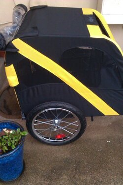

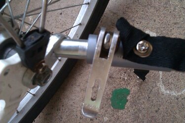

Both wheels are quick release, you push them into their axle, you remove them by pushing up a fitting underneath.
The trailer, once assembled, is sturdy. Beware, it is much larger than it looks in the pictures, I found that I can't get it out of my back door with the wheels on.

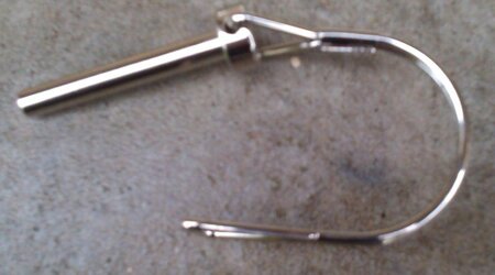

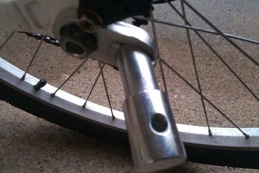

The trailer tow bar is meant to connect to the trailer and to the bike with 3 sprung cotter pins:
2 should be used to connect the bar to the trailer, one to connect the bar to the bike fitting:
I got only 2 in my box, so I emailed the company, who wanted me to print, sign, scan, email, a "missing parts" document.
I could not be bothered, so I bought one from a spare trailer parts online shop in the uk: could have saved myself the money, as, while waiting for the pin to arrive, I experimented with a quick release nut from an old seatpost, it worked perfectly.

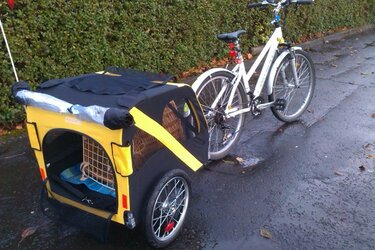

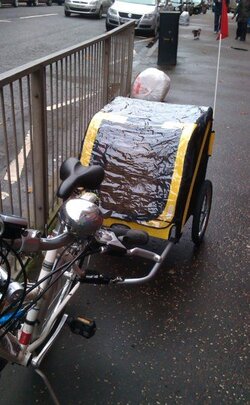

The trailer and bike ready to go:
I've fitted it to a bike with a kickstand, for parking purposes, indeed having a kickstand helped a lot.

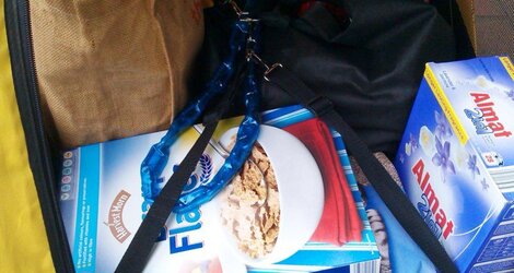

An immediate observation at this stage is the securing of the trailer while you park it: as it comes, there isn't a hook or similar to chain it up.

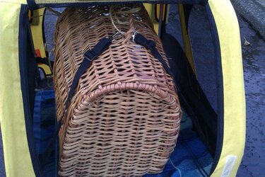

The trailer used as pet carrier.
I overcame the problem of the trailer being too big by putting the cat in its carrier first, then securing the carrier by the luggage kind of straps fitted to the trailer. It comes with 4 straps, that I think are meant to secure a dog wearing a body harness - if this is the right term. A cat could claw itself out, btw, even if the trailer was smaller.

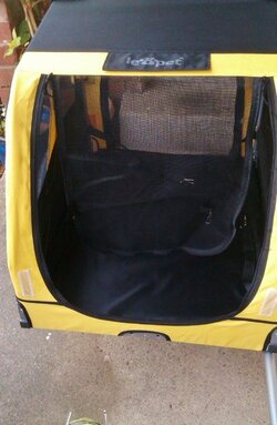

The rain cover protected the cat from our permanent scottish drizzle, the tyres are chunky enough to minimize bumps. Dirt was simply washed off with a damp cloth back home.
About the rain cover, it has a tendency to become loose from it's velcro fittings at the side, but the wind had lifted a fair bit on the ride home. The trailer itself remained stable in moderate wind.

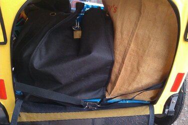

The trailer used for cargo.

I knew my max load is 30 kg, got some bulky shopping, loaded it like this:
Because I was not sure how the trailer would behave downhill fully loaded, I went through the cycling path and the park instead of the dual carriage way (I'm not completely
The bit slightly uphill was heavy going, even in 2nd gear, but the trailer gave no signs of unbalance. Going a fairly steep downhill with bends was also ok, slowly did it.
I rejoined the main road with no issues, apart some huffing and puffing: out of curiosity, I weighed my cargo on arrival home, it was 28 kg - as I mentioned, 30 is the max recommended.
