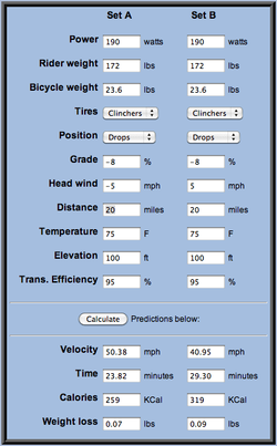

I like my top gear to be a bit higher than you guys so I'm able to power through to circa 50mph @140rpm, but that maybe because I've not got any long descents around here so I have to take as much advantage as possible from the inclines I have.

& very little idea about prevailing conditions it seems...
fyi: 190w is around about my maximum power at 140rpm
