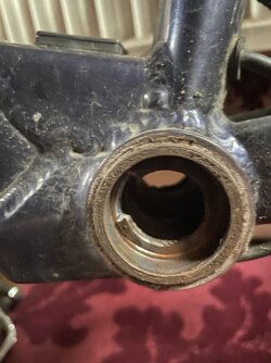

Good afternoon,
I bought one of the cheapo tools that you hit with a hammer, it broke the press fit unit rather than drive it out!
Yes this is a press fit BB (BB72), the tool broke the "ridge" and pushed the bearing out of the cup, leaving the cup in the frame!
I made the mistake of buying something cheap because I wasn't going to use it often and the better tool was described in as being unsuitable.
