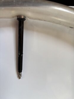

Definitely Presta.
The core on the LHS fits, the core on the RHS does not.
whilst I can’t see any obvious defect, I think the RHS has a bad thread. It was in a bag, but I do not know where it came from.

This is TPU tube that I couldn’t inflate with my mini pump.

This morning I removed the inner tube, cleaned up the tyre and valve stem. I haven’t got the correct rim tape so will drop it in to the LBS tomorrow to reassemble.
