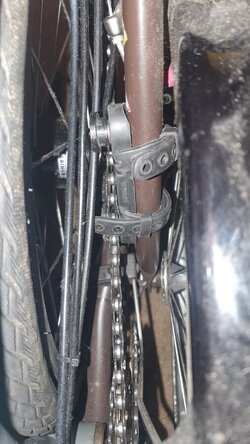

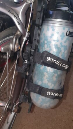

I think you're wrong.
I can fit decathlon strap on cage mounts onto my standard Brompton forks non-drive side and use a Gorilla cage or Monkii cage no problem and it folds just fine with the mounts in place.
Obviously I could do the same on the new model but it would have been better if they made it with bosses already there.
Also, it's no big deal to fit or remove a normal bottle cage if you're only folding the bike a couple of times a day at the start or finish of a ride.
