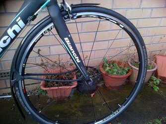

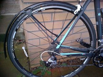

I was looking at these mudguards in Evans last week and thinking of doing something like this to my bike. I have got the Crud 2 mudguard fitted ok on my road bike on the front but can only get the Crud 2 fitted up to brake caliper on rear. It stops my backside getting wet but would prefer a fuller mudguard on the back. You have got me thinking again
