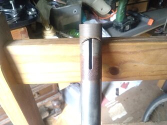

Hi. I am restoring a R20 and have stripped it down and ready to spray. I removed the front forks and noticed a T slot in the stem. Can someone please tell me what it is for. I watched a thread and it mentioned removing the forks and said be careful about dropping the bearing. Is there a bearing that fits in the T cut out for something, or was the post on about the bottom bearings of the forks. Thanks in advance.
raleighnut
Not sure on the R20 but a lot of Raleigh forks have a slot that engages with a tab on a lock ring to prevent the top race from moving, ham fisted 'mechanics' have been known to force the nut tighter to 'adjust' the play in the headset.
Piccies would be useful.

This is the slot.

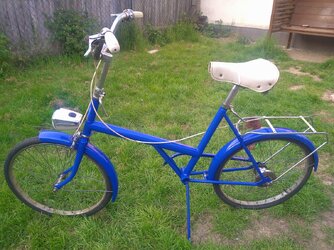

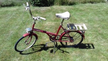

I have kept the plastic bushing for now. I have been looking at getting a bearing race set for it and a different raleigh handle bar stem. I am thinking of keeping the original pedals and changing the wheels for BMX ones and single speed.
I wss thinking about the "T" slot and had an idea what it was for after I wrotethe question, but was still not too sure until reassembling the bike. At least, I hope I have re=assembled the front forks the right way. My memory i terrible and I forgot to take photos of it. lol. I remembered to take pics of the witing in he headlight though.
This is a before and after of the bike. I have not finished rebuilding it yet.

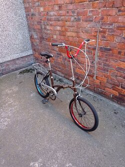

@ianpallen .... BMX on my Kingpin [folder]
Plates made to drop the stock calipers to suit rim.
