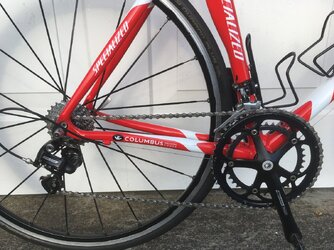

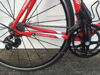

Thanks guys for your comments and feedback - I attach a pic of the rear derailleur showing the cassette in contact with the cogs of the rear derailleur - this means that I'm currently unable to use gears 1 and 2 ( the lowest gears / biggest sprockets in cassette). If it's a case of shortening the chain, then great but I do remember the LBS talking about clearance issues re RD / chain / gear setup (i.e. 53 x 39 / 13 x 25) etc.

Thanks for the pics.
If the chain was on the 53t for those images, certain the chain's too long.
https://i.ibb.co/qsyvJpZ/Screen-Shot-2019-07-29-at-2-52-26-PM.png
I asked: "Let's have a side view image of the chain (complete) in large/large.
"Bonus: one in (Edit) small/small." Please, and see below.
"the chain rubs against part of the derailleur when using the lowest gears 1 and 2." Which part?
With the cable unclamped, can you manually push the RD/cage across underneath the two largest sprockets?
https://support.campagnolo.com/media/files/035_259_Technical manual - Mechanical units rear derailleur - Campagnolo_Rev03_02_23_EN.pdf
See Figure 10 and screw 'H' which has the function of dropping the guide pulley wheel down (if that's the issue).

AB - thanks for this - will put my bike on the turbo tomorrow and another pic re above diagram. The pics shown before were in the small ring and on the second lowest (second largest inside sprocket). Thanks again.

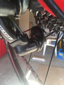

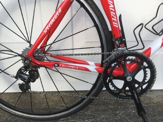

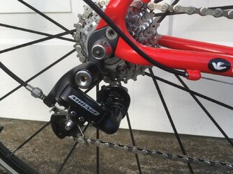

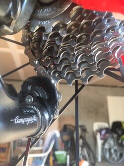

Guys - finally we have additional pics with chain in big and small ring and top and lowest gears at the back. Re the issue of cassette touching the jockey wheels of the rear derailleur, I'd be wanting to use gears 1 and 2 on the small ring - i.e. to make things easier when going up steeper hills. At the moment, the lowest gear I dare use is gear 3.

Ajax Bay
East Devon
Thank you, however.
"Bonus: one in (Edit) small/small." Please.
Your images do not meet this simple spec. If you are concerned about pushing the chain onto the largest sprocket, at least get it on the second largest.
Have you adjusted (in/out) what is normally known as the 'b' screw but Campagnolo has "H" screws and they work in reverse? To drop the pulley wheel down.
Please also, as a special treat, check the number of teeth on that large sprocket, which you say is 25.
