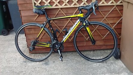

According to the product page @DCLane shared the rims have a braking surface (for rim brakes) and the internal rim width is 15mm, so max 32mm tyres (like the OP's current ones - see image). And double butted spokes (28 or 32) with brass nipples (tick).
Ref the 1.8mm spacer, it'd be worth taking the current cassette off and checking what spacer is there: if two: happy days. Otherwise LBS, I suggest or: Spa Cycles

There is no spacer so thanks for the link. I just then need to get some rim tape as they don't come with any.
