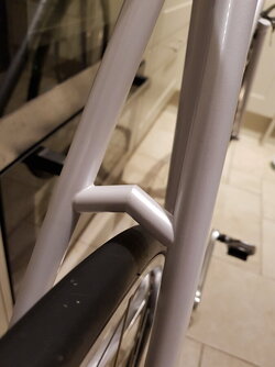

The rear seatstay bridges on my two track frames couldn't be drilled for a brake anyway: one is very small diameter and the other is a bit of framebuilder (Jim Bundy, used to build Olympic track bikes for the Autralian team) showing-off:
