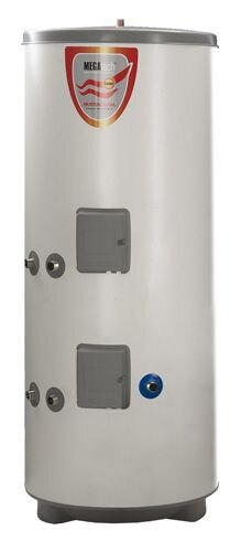

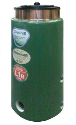

Interesting, am I correct in thinking that if you don't have loft space for a cistern then you need either an unvented tank or a combination tank (i.e. dual chamber) ?
Correct
A combination cylinder has the cold water storage tank built on top
Con: poor flow rate possibly non existent in a flat
An unvented cylinder connects directly to the mains water
Con: expensive to buy and install (need to be qualified to install unveted)
You could consider a thermal store which has the advantage of unvented hot water but without the complicated installation
Checkout the Albion Mainsflow Electric (pg 9)
http://www.albionwaterheaters.com/pdfs/sales/mainsflow.pdf
