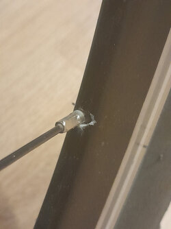

Hello i have question, do i have to do something with it, spoke moves because the disc is damaged here.

I would replace that wheel asap is what i woud do with it .

The rim has failed and needs replacement, if it's still within warranty contact the manufacturer, they will replace it.

If that was mine, I'd attempt a bodge with a washer inside the rim.

I'm not so sure how I'd feel if I was whizzing down a hill full throttle knowing the rim wasn't 100%. However, seeing as I've got a miriad of rims down the shed I'd happily spend an hour or two replacing it and building another wheel. Whether it's built or bought I think it needs replacing but I am getting nesh in my old age and try not to take the risks I was happy taking not so many years back. Unknown risks are one thing but known ones are another.

I had the same on my rear 700c. Fatigue cracks around three or four nipples. Put the bike away until I got a new wheel.
