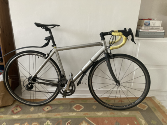

Here's a pic of my Allez... it needs a clean. The front Campag shifter has snapped off and will be expensive to replace. I can just about get by with the rear gears, though it does limit speed.
