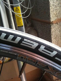

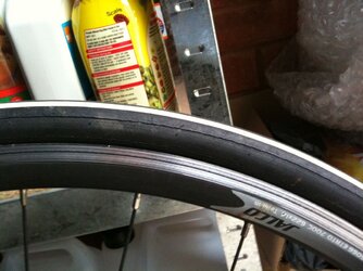

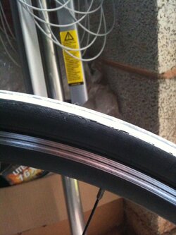

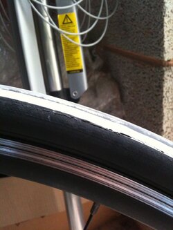

I was giving the bike a clean after the riding the Dartmoor Classic at the weekend and noticed the state of the tyres. I'm not really experienced enough to know whether this sort of damage/wear/whatever is acceptable or not, particularly with a triathlon this coming weekend.
The tyres are schwalbe ultremo R1, new in April, I can't be sure of the mileage, thought I wrote it down but no more than 400-500 max.
The first photo shows some sidewall damage to one of the tyres, which I would expect means it's scrap, this damage was what made me take a closer look to see all the other splits/cracks/trailing rayon in both tyres.

It's hard to tell from the pictures. Can you see through the rubber or is it just a cut in the outer surface? The top photo looks the worst, I can't see anything in the others that would bother me unduly, just very carefully cut the bit off in picture 3.

On reflection, I think I agree with you. Looking closely at the construction of the tyre, there is an extra "fabric" layer around the inner edge and the outer coating of rubber is extremely thin that the edge of this has allowed the "fabric" to come lose. I doubt the extent of this as it is at the moment poses any structural risk.
In other areas of the sidewall you can make out exposed threads where the rubber is just applied too thinly, whether this accounted for the big nick in the first photo or not I don't know.
The other 'splits', well, they don't go deep, you can't see any 'fabric' layer or anything so I'll go with Sheldon on that one.
The big nick in the first photo does have a very slight bulge, so if I can't get a replacement for saturdays race, I'll stick it on the back wheel and put some sort of tyre-boot on the inside.
