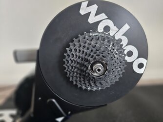

Figured, I would tear it down and repair it while waiting for the new casette to come in from Amazon. I'm in IT and have a Hakko soldering station, multimeter, and some basic repair experience. Started off as an computer technician back in the day, so no biggie to make a new molex to barrel connector or what not. Anyway, when I go to pick it up, I end up giving the guy $160, bc he wanted cash and I had to stop at the bank ATM to withdrawal the cash and it only allows increments of $20. I said, I'm not worried about the $10, still a great deal. I mention needing to order an 11 speed cassete and he says, hold up. I have the one that came with it and I'll never use it. You can have it! He also mentioned the cable only really acts up when you pull on it! That he has used it like that for a long time without any real issue. Well that sounds good to me, I just won't pull on it! Lol
Instead of tearing it down, decided to just set it up! Went pretty smooth considering I've never swapped a cassette before.

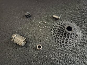

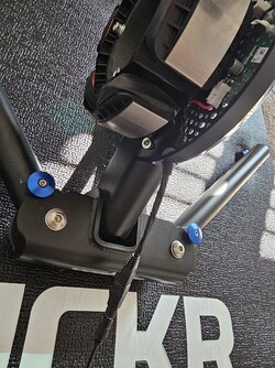

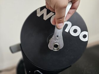

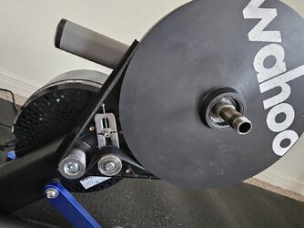

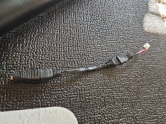

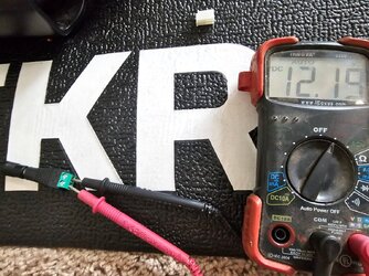

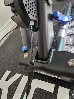

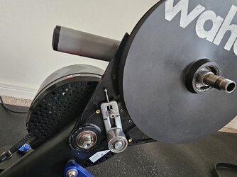

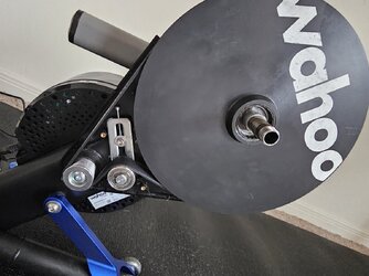

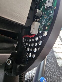

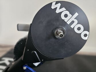

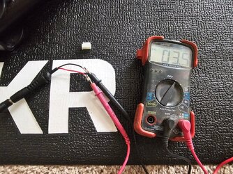

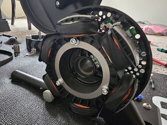

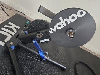

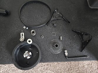

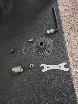

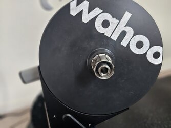

Even though I didn't have any issues with the trainer (it stays on if you don't physically wiggle the connector), I went ahead with the repair anyway. Text below copied and pasted from my FB bc too lazy to re-write it lol.
Was "stuck" at home, as I was on call yesterday for work so decided to make use of my time with a little project.
So I picked up this Zwift Kickr v4 for $160 on FB Marketplace due to it having a wonky power jack, and the seller bought a new one. Supposedly seller bought it for $1200 new (2018 model so obviously a good 5+ years old, but still thought that was a great deal). To be fair, the unit worked fine as long as you didn't jiggle the power cord. Could have likely just let it be, but figured why not take a crack at repairing it.
Pics are in reverse chronological order. As far as I know Wahoo does not sell the power pigtail connector. In fact they give you a discount on a new one if you call in with issues.
Total cost of repair ~ 15 bucks and some elbow grease. Was being lazy so just bought a 10 pack of pre-wired connectors (3.96mm Pitch Female Connector) and a 10 pack of 12v female power jack adaptors. So really only ~1.50 in material used LOL. Could have likely just soldered directly to the board and found a female adaptor for free 99. but either way, all good.
Used Ethernet boots that I had lying around for strain relief and as grommets inside and outside the case just because. A little back tape and Bob is your uncle. Good to go! Not perfect, but good enough for me.
10 file limit reached... see next post for more pics if you desire.

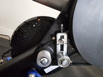

philipgonzales3
philipgonzales3
Welp, that wasn't TOO bad. Hardest part was the silver pulley on the bottom left was seized up pretty good. Took a ton of prying. Also the key was the same, but at the end of the day I got it done.
Edit: Revised Imaged
