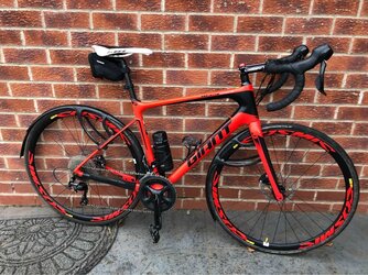

This is the bike I'm going to look at. From the pics, it looks in great condition.

Check the wheels are true, the tyres aren't excessively worn, that the brakes work, that the pedals and cranks are firmly attached (but that the pedals can be loosened so changed), that the bottom bracket doesn't creak, that there's no play in the headset, that the chain doesn't slip, that the cassette isn't over worn, and the chainrings aren't shark toothy, make sure the seatpost can be adjusted up and down with ease and other bolts aren't rusty and seized
Ask how it's been maintained and when it was last given a good check over/service (by shop or owner)
Ming the Merciless
There is no mercy
Photo Winner
Inside my skull
You can usually get a feel for crash damage if you have the opportunity to ride it. Does it ride well, do the bars turn cleanly and smoothly, is the ride silent? Plus check every inch of the frame and forks.
figbat
Slippery scientist
I’ve bought two second hand carbon bikes - I test road both but spent most time inspecting the frame visually and tapping it to listen for any unexpected resonance. Both have turned out to be solid bikes.
DRM
West Yorks
As others have said, check it’s the sellers to sell, everything works, wheels are true, bearing play at BB and headset, Check frame around seat tube for cracks, it’s not unheard of on bikes with a lot of seat post showing
