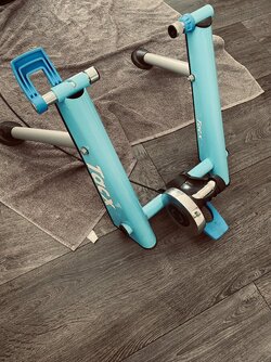

I have a dumb turbo and have just been given another one, a tacx one.
Just given it a whirl but after about 5 mins, tye smell of burning rubber was very strong and that doesn’t happen on my other turbo (a Saris one).
When I stopped, I noted the roller itself was very hot indeed but the instructions say it could get very warm.
Would a turbo tyre help?

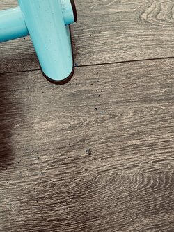

I should have said that the third pic shows some rubber on the kitchen floor but you may have to zoom in to see it lol

I've not experienced it first-hand, but I believe a normal tyre designed for use not on a turbo, will rapidly wear and get very warm. Turbo specific tyres cope much better.
Loch side.
Those a tyre eaters. Use a special turbo tyre and/or inflate your tyre as hard as possible. It can easily eat a tyre in one session if yoiu get it wrong.
Dogtrousers
Lefty tighty. Get it righty.
A turbo tyre is better, yes. My experience is that they wear better and are less messy as they don't produce bits of rubber dust.
But I think there must be something else awry because I never got a smell of burning rubber with an ordinary tyre.
fossyant
Ride It Like You Stole It!
South Manchester
Roller too tight on the tyre ?
Loch side.
Just an update - got a turbo tyre, put it on and no more burning rubber - result!
Just seems completely odd that this type of trainer would eat a tyre, I have used my other one for years and never had a problem.
Maybe I was going so fast on the new turbo that the tyre couldn’t cope, then again……
Result. No speculation required.
