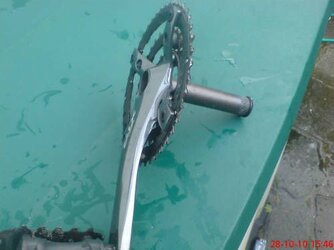

just to confirmn, this is photo of the chains set, pretty sure that is hollowtech II .(and not octalink) ...... I hope.
02GF74
02GF74
ok, linky no worky, so attaching.

^^ GREAT - THANKS - once i get the bb, i should be able to work it out - already fitted on of them just not on my bike.
