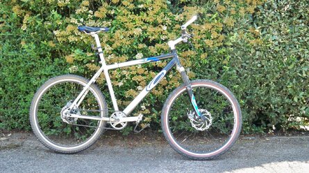

Click on attached photo of how the tensioner ended up. Love the simplicity and quietness.
Also did you replced the rear cog?
Apologies if i am telling you how to suck eggs, just my own experience.
Cheers.
PS, I have managed to fit a 1/8 chain with no tensioner, so far it hasn't jumped and there is no binding.

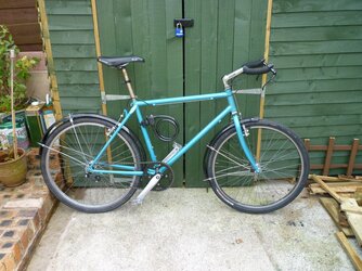

Thanks both. I think I've sorted it now - does seem to have been a tension problem. Taking another two links out and adjusting the tensioner a little makes it ridable. It is a little clunky though - I think a new tensioner is in order - it's a bit old this one.
I did pretty much fit what was originally done on it, pedallingpasty. Was 46/16, now 48/16 (it's a commuter, not off roader!)
Might as well stick a photo here now it's (finally) sort of finished! Thanks for all the help/advice.
