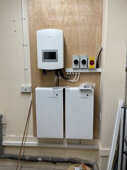

Fly Fifer
Batteries and inverter in the garage . All wiring done , just got to get panels on the roof
