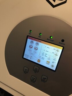

Not too bad considering that it’s a dull winter’s afternoon (this morning was beautifully bright here)…
