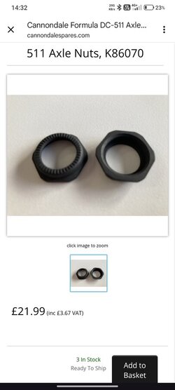

Does anyone know where I can get one of these (or an alternative)?
Front axle bearing locknut from a 2021 or 2022 Boardman MHT 8.8.
The hub is unbranded with no serial numbers though is apparently made by Formula and I think it's this one -
The part I need is number 8 on the diagram, 'end cap', or at a pinch the axle kit. I've drawn a blank trying to find either.
The end cap is 23mm AF, 6mm high and screws onto a 19mm diameter axle.

Is it worth an email/call with SPA or SJS Cycles - they should have something that fits ?

Any good?
https://www.cannondalespares.com/Cannondale-Formula-DC-511-Axle-Nuts--K86070/product_detail/3-51010
Possibly... the picture won't open so I can't check what it looks like.
I've found the replacement axle kit online. In New Zealand. :rolleyes:
$NZ 26.08 but they don't ship to UK.
Picture attached (I hope, having some problems!)

Axle nuts arrived promptly, MTB back in action.
Even the sheep are impressed. Thanks @wonderloaf for the link.
