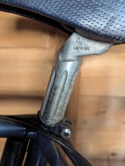

Not splines but mine has some grooves milled into it, just for aesthetics or summat.

I am very confused, because that picture shows a standard SR Laprade seat pillar, which was a very popular budget model for those who couldn't afford Campagnolo or similar, in what was a completely standard seat clamp on quality steel frames. I don't completely understand your description of the wedges. What is different about this frame?

The photo is not the frame in question, another posters possible guess, as mentioned a few times photos of the actual frame and seat post would be 'most' helpful

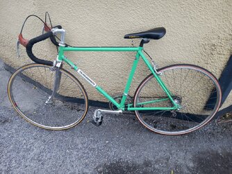

The T W Holdsworth on the frame relates to an electrical shop in South Shields that also sold a few bike parts.The business was then taken over by Norman Fay who started building frames.
The groupset is Shimano 600 with a Cinelli bar and stem,mavic wheels with dura ace hubs.

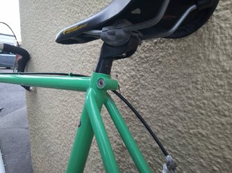

The 2 wedges slot in each side of the housing behind the seat tube.They butt up to the grooves in the seat post internally and a bolt squeezes them into the groove.

maybe a photo that actually shows the wedges your trying to describe would help.....
My first thought is the frame isn't lugged so maybe not as old as its trying to be?

Indeed. If that's as old as 1990 i'd be mighty surprised.
Lugless construction, the forks, the (rather pointless) seat post retaining/adjustment arrangement, rhe profile of the seat stay-seat tube junction...cant go by the finishing kit as its clearly been apart and repainted and who knows what kit when back on it afterwards.
My gut call is in the 92-95ish age range.

Indeed, a photo or two with the seat post removed, and looking down the seat tube would be useful.
