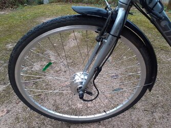

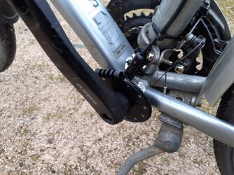

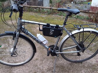

Just completed this attachment to my Giant Escape bike. The kit comprised of a 28inch front wheel with motor; a battery power pack; a charger; pedal sensor and cabling. It is neat enough and fitting was easy and for £299 + shipping £30 it represents good value. The bike weight is now 19.5kg (43 lbs) compared with the original 12.8kg so it’s an extra 7kg, heavy enough to struggle lifting it onto the bike stand or camper van bike rack, but just manageable.
It has no throttle control so it kicks in at level 3 (of 5) regardless of gradient or pedal speed just as long as you are pedalling. It cuts out at 15mph. It kicks in at the first turn of the pedal and the assistance it gives is very obvious. You need to use the gears to get uphill but the assistance is still there and this is the great benefit for me. The battery life is short. A week of town journeys with hills. Not suitable for long distance touring unless you switch it off and only use it up hills. Great fun though and you can still use the bike just as normal when the battery power runs out.
