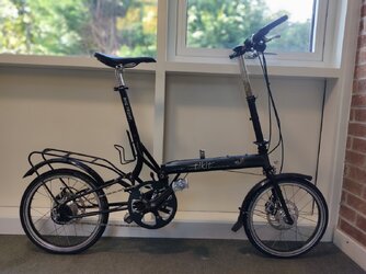

Not a New World tourist but a Tikit I think is with a Nexus 8 speed, disc brakes, dynamo, is on sale in the classifieds by me at a very reasonable price. It's even packed and boxed ready to be shipped, (from UK). Let down by a CC buyer in Germany who just disappeared So if you fancy dipping your toe in the water for minimal cost...
Excellent condition, just needs new tyres.

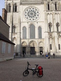

It hasn't needed any maintenance on the suspension yet. It is only a metal spring on the front and a rubber insert on the rear I.e. a single piece. There are some additional joints due to the folding mechanism but all folding bikes have some version of these.
That is a pair of small panniers (2 x 10 litres) on the rear plus a bag on the top of the rack. It should be possible to fit another pair of panniers on the front.
Not meaning to be argumentative but without distance/time the need or otherwise to service the suspension is not very useful. I see 'suspension' and my head jumps to servicing.
