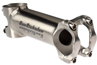

I don't think it helps that in the case Van Nicholas stem it is quite cutaway at the back. I have seen carbon fork steerers crushed by this stem due to over tightening, as the steerer starts to fail it will invariably also translate to a creaking noise and often people will assume that noise is due to the fact the bolts are not tight enough; then tighten them even more which only makes the issue even worse!
In conclusion I would never actually recommend that combination........ says me having had my Van Nicholas Chinook since 2007 and with one their Ti Stems fitted!

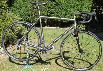

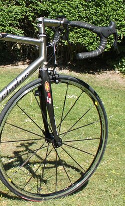

I can confirm my Easton EC90 SLX forks do have a carbon Steerer, if you look closely at both pictures you can see just how cutaway the stem is which of course also exposes the carbon steerer
