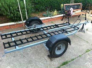

Thanks for the help guys I know my thread isn't a typical one but as everyone is so helpful on here I thought I'd give it a try cheers. I've ordered a motorcycle trailer to be built from http://www.davecooper.co.uk/bike_trailers.asp
It's being custom built as my trike is so long & it's so much more cheaper than any other of the competitors even before being customary tailored for my trike AKA 'The Beast'. I've been charged at the normal price & they're a very friendly & happy to help company. I think my Ford Focus 2.0TDI should tow well & hopefully I take to towing as easy as I did learning how to drive & steer with my feet after driving the conventional way before I paralysed my hands & arms in bike accident. Here's what the trailer will look like minus the Harley -photo courtesy of Dave Cooper bike racks ^_^

Good move, at least you will know the trailer is going to be safe, legal and warrantied.:thumbsup:
