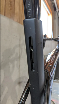

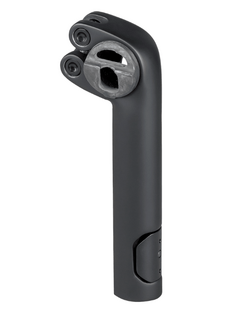

So, I bought my 2022 model Trek Domane SL5 Gen3 new from a Trek Store in my city in May of this year as my first road bike. I am 6'2" with a 33" inseam, which is short for my height. So I bought the shorter seat mast and swapped it since I felt the original one that came with the bike was too high.
Just FYI, it is a proprietary design. So I went ahead and paid the ~$250 USD for the new seat post and called it a day. Can't put a price on comfort right!?
NOTE: Not my pictures below, just from the internet for reference.
So, I'm a little fuzzy on the timeline but at some point I start having issues with the seat post wiggling and creaking etc. The shop says, oh things weren't torqued down correctly. All good now. I believe they added carbon paste as well. I don't quite remember if this was before or after I went to the bike fitter. I THINK it was both before and after I went to the bike fitter but my memory isn't the greatest.

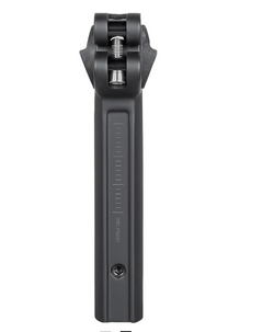

Anyway, so about the bike fitter. He cranks my saddle height up (A little at a time of course, checking the angles and my motion and what not through the pedal stroke) and when he goes to torque down the seat binder bolt/screw (I just call it a set screw) his torque wrench slipped a bit and he commented on not caring for the design of the seat post too much. I didn't think too much of it until I started reading about how soft the set screw and remembering the bike shop telling me one of their customers had to get a new frame due to the set screw stripping out completely and thus the seat post was unable to be removed so that turned into new frame day for the customer (I assume on the customer's dime, but I didn't ask).
Anyway, after visiting the bike shop once or twice (pretty sure it was twice), all was well. That was, until I bought a second hand smart trainer and started doing a "virtual bike fit" (MyVeloFit online) on September 12th. It mentioned that my saddle height should be lowered 10cm or what not and I kind of felt like it was correct in that my saddle height was too high. Oh I also purchased a new saddle, so figured that could be some of the "issue" of why my saddle height needed more evaluation. Felt kind of bad "cheating" on the fitter but figured only one way to find out what I really like is by trying different things. I can always adjust back if needed.
So when I adjusted my saddle I noticed the set screw was getting more and more rounded (the hex part where the hex key/torque wrench engages it). Since I had the original seat post, including the set screw and what not I said no biggie I will go ahead and swap the screw over (the whole binder kit really). Well, the wiggle in the seat post was back now. I torqued to spec and no go... I figure, well let me loosen the set screw and try again. Well, same exact thing happened to me. My torque wrench slipped before getting back up to the right torque.
