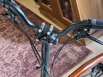

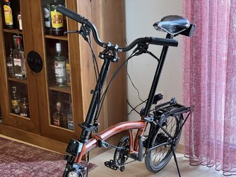

I noticed that I’m more comfortable with straight riding position. So I’ve upgraded my M model to H. M handlebar seemed not wide enough and I wanted:
a) a little wider handlebar
b) have back sweep for more ergonomic position of my wrists

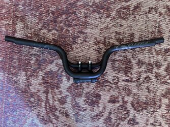

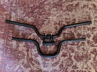

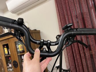

The only choice I came up with to match the stock M handlebar rise was JC mid rise (71.5mm) and Satori extender (50mm). In theory it should’ve given 121.5mm rise which was about the same with 130mm rise of stock M bar. After installation today I noticed it wasn’t the case and some of the cables seemed to become short. Still I test ride it today and was pleased with a little higher riding position. My head was upright, neck more comfortable.
Update: JC midrise handlebar rise value of 71mm on JC website was incorrect. I understood it checking listing of the same item on SJS website which reads the rise to be 100mm. Now it all make sense.
Final result. Adding Satori extender (50mm) and JC midrise handlebar (100mm) will provide 150mm rise compared to 130mm rise of stock handlebar, so you will have about 20mm higher rise and 12 degrees back sweep. It
H stem will allow to clear the fold if handlebar is cut to 55cm width using markings on the handlebar. NO cables changes will be required.
