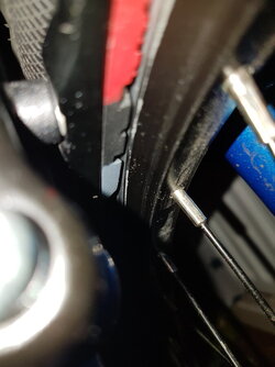

Hi, hope you are well. I was wondering if the v brake toe is set correct. I used the rubber band method and placed it on the back side of the pad. Please see attached. Thanks.
jay clock
Massive member
Hampshire UK
Cannot see any rubber band. i use the small bit of cardboard method. E.g. a bit of cereal box about the size of a postage stamp. Insert this at the back of the pad so that the front of the pad is touching the wheel. This means the front of the pad will grab the rim first
Bsmith
New Member
Can't really see by your photo but if you had a thick rubber band around the back edge of the brake pads it should be ok, main reason for doing this is to keep the pads from screetching when braking.

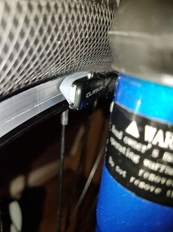

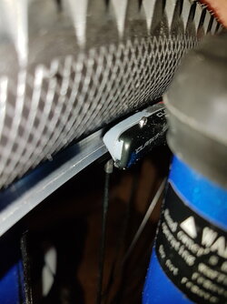

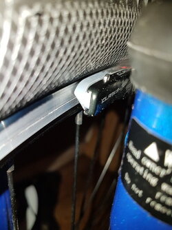

Is this fine?

Can't see from those pics how much toe-in there is.
Don't over think it too much and don't worry about the best method. Just try to get the rear of the pad a mm or so further away from the rim than the front.

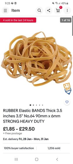

Is it not working because im using thin rubber band? Also would this rubber band do?
