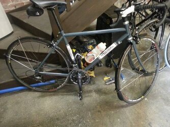

I have an easy come easy go steel all rounder very sturdy bike
