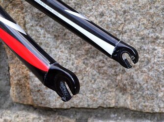

Excuse my ignorance, but why is it difficult to remove the wheel, even if the fork dropout have got LLs (never even knew what they were until I read this thread). Don't you just unwind the QR lever a bit more to clear the lips?
The point is that if you don't have LLs you don't need to unscrew the skewer at all, which means you don't have to faff around readjusting the tension again when putting the wheel back in.

Yep, I'm definitely being thick, I still don't get it 😆. I went to check the front fork on my bike and it does have a "lip" on the dropout , that I'd never noticed before.
Thing is, even without the LL, you'd still need a skewer otherwise there's nothing holding the wheel in place!

I was curious enough to take this photo of the front dropouts on my road bike. There's a little lip/tab on each dropout... to clear it when removing the wheel, no big deal, just unwind the QR lever, the tab only protrudes a couple of mm.🤷🏻‍♂️
