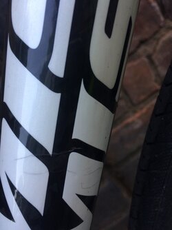

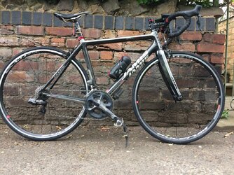

I used this for a year or so for an 18 mile each way Mon-Fri commute, all weathers
I did cry a bit when needing new Ultegra outer chain rings (£100+), but I used 105/Tiagra level chains and cassettes and I would still be using it now except for this.
It's not obvious in the photo but there is a crack or two, the frame goes thud not ding when tapped with a coin around this area.
Once you accept that you are to getting wet, getting soaked within the first mile is no worse than it taking three miles and you are never disappointed that you didn't remain dry.

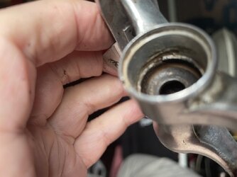

Yes, do the maintainance, I have a normal bit of road that can flood quite deeply and I trounced a pedal as it didn't like being immersed and I was not quick enough in regreasing it.
Somthing went wrong, there was this grinding sound and the end cap came off and the ball bearings fell out!
