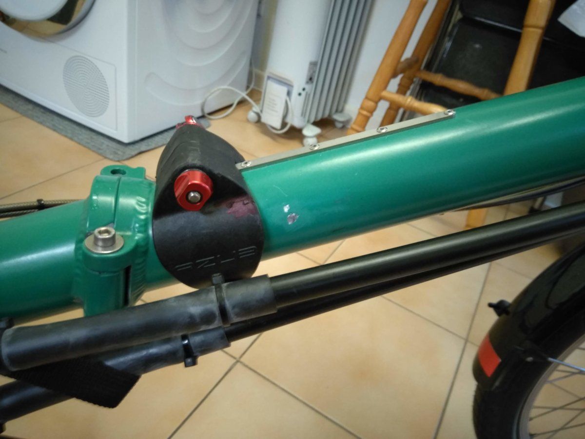

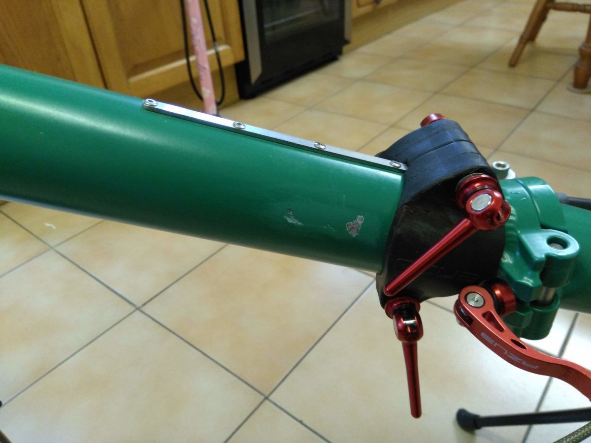

Maybe it was the time of year or maybe the tape over the frame hiding a reputedly "minor scratch" put people off. I guessed that it might have been caused by the seat coming off the seat clamp so I took a chance that it wasn't too serious.
At first glance it looks like paint chips that someone has tried to smooth with wet and dry paper. Further examination reveals a bit of a depression or gouge. So not too impressed but Azub frames are known to be bullet proof, 3mm aluminimum tubing possibly so losing 1mm is probably ok. And indeEd I found that the seat clamp was not properly adjusted, so the seat bracket was not supported on the seat clamp bolt at both ends. I also found the chain was twisted.

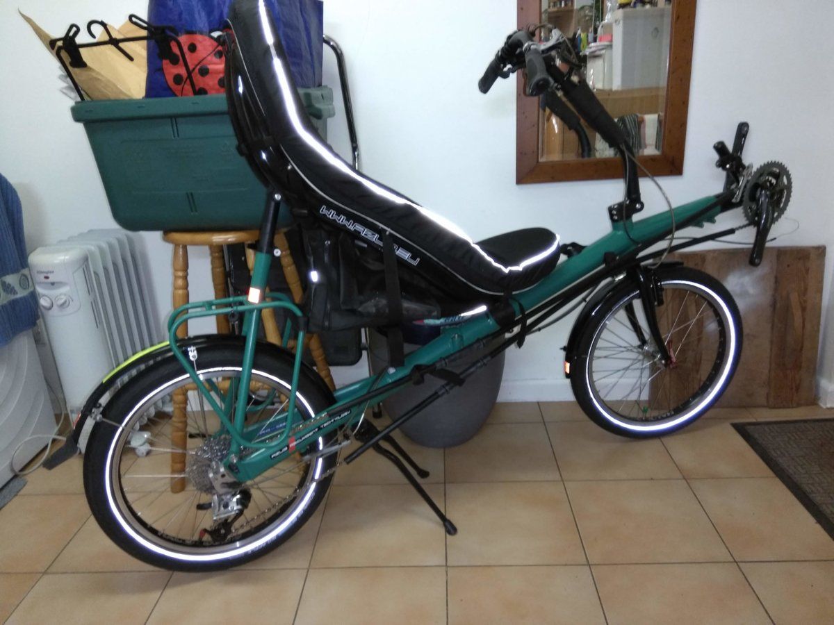

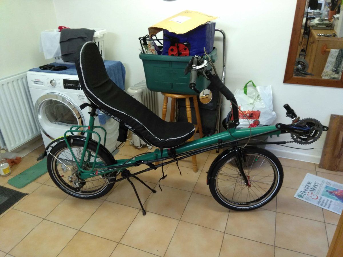

All I've done so far is reassemble it and check all the clamps. I've positioned the seat 25% from the front of the seat rail. It's still further from the front wheel than the seat on my Nazca Paseo SWB. It came with an incompatible 22/32/44 XT chainset. Incompatible because that provides ridiculously low gearing, and because the chain rubs on the stay when using the 11T sprocket. There's some protective tape there but I think it would wear through PDQ.
I really think the underseat bag and the integrated rack is genius. It will be a while before I ride it. I've decided to fit a 34/48 compact crankset after I've had the cranks shortened - my preference and it should reduce heel strike.
