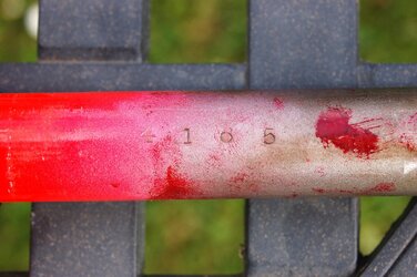

I was just looking at the expander. It is a cone type, other ones I have have little pip on them which locate in a slot in the stem, this one doesn't have one and was just turning and still expanding the stem. It's now out so I will see if I can loosen the thread.
Illaveago
Illaveago
I have managed to save as much of the frame as possible.
