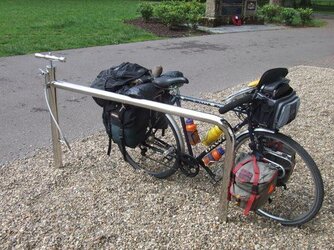

This is what one of my hubgeared bikes looked like before the weekend.... but it has changed a bit since, what with fettling being such good fun.
