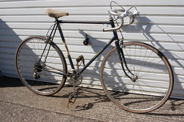

I have just acquired this Holdsworth Cyclone from my BIL. We did a straight swap. I swapped my Holdsworth Avanti 501 for it . My BIL rescued it from a neighbours garden where it was left out in all the elements. It is a 24 inch model . A bit ouchy in the undercarriage department for my BIL . I can manage a 24.5 inch without any problems so it should be okay.
I think the bike is from the mid 50's, it has a frame number stamped into the LH rear dropout, 1**?46 I think, just going from memory . I know it begins with 1 and ends in 46 the other numbers are indistinct.

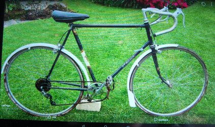

The bike is not in original condition as it has Weinmann side pull brakes from the 80's, the gears are Simplex , a long cage version at the rear. I think it was fitted to cope with the dinner plate rear sprocket. It is a bit hilly where the bike came from .
I have just started cleaning up the bike today and have started to de rust the cranks and some sections of the frame which is suffering from a lot of patina, rust.

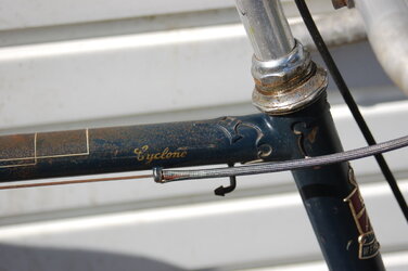

I was just doing a bit of research . The latest date for the bike would appear to be 1954/55. The use of a metal head badge and the fact that it hasn't got Nervex Professional lugs would narrow it down to those years .
The rear dropout is made for the Cyclo Benelux derailleur .

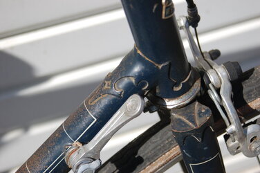

The box lining has been done very well. The rear stays also have been done and show the skill of the person who did it . It seems a shame that the lugs weren't also picked out as the intricate shapes are lost in amongst the dark colour of the frame . There is some evidence of the fork crown being picked out in white but as far as I can see the lugs don't seem to have been .
