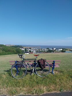

I recently bought some scwalbe durano raceguard 35c tyres for my heavyweight steel tourer / do everything bike.
They replaced a worn out pair of 25c durano plus.
I didnt think to get new tubes so used the old ones which were sized for 23 to 32c . They seem to be ok after a few short rides .Would it be advisable for me to replace them for larger tubes asap or dont worry.
