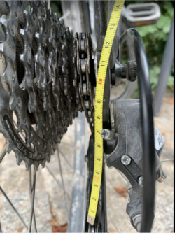

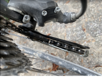

With the chain in the smallest sprocket, what direction does the rear derailleur cage point to eg 8 o'clock?
With the chain In that sprocket,
a. How far (in mm) between the return section of the chain (ie from the chainring) and the chain on the 6 o'clock point of the upper jockey wheel?
b. How far apart (in mm) are the upper pulley wheel and the sprocket teeth?

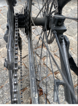

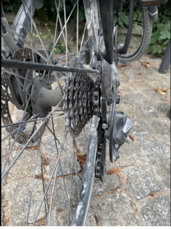

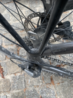

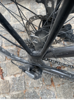

Can you post a side on photo of the drivetrain with the chain on the smallest sprocket please.
What’s a bike tray?
I live in France even though I'm from the US. It is in French a "plateau". Even ALMIGHTY GOOGLE doesn't seem to know what the heck that is. It's the gear under the pedals. I'd love to know the English term.
M
Marais
Active Member
OK here is the whole SHLABANG in images. Still, rarely in gear 8 it "pops".
I'll send multiple photos just to be sure you guys have all you need.
Many, many thanks!
I saw your images on the other thread and could see the chain was correct length (if too long, might have caused the symptoms described). Which is why I said 'ignore the questions'. Which you did (see questions above asking for quantatitive answers: not answered by those images).
