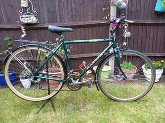

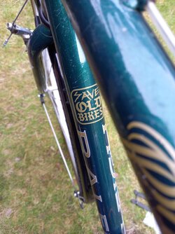

Few tweaks to the Pioneer. Replaced the horrible plastic Lee Chi cantis with shiny Shimano alloy ones. Replaced the all steel front mech with the alloy Suntour one to match the chainset. And added the finishing touch. Just need the all clear from the Physio and I can ride it at last.
Hope you get to test it out soon :bicycle:
