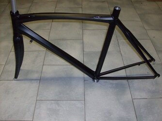

I am going to buy a 57cm alloy frame with carbon forks, the frame was made by Dedacciai but there are no labels (see photo)
Does this happen sometimes when a maker doesn't put on labels? The seller has this frame in different sizes and also a raw frame.
Does the frame appear to be a Dedacciai frame? The price is around £140.

Deda sell a lot of aftermarket frames - couldn't tell you if it was Deda or not. Try comparing it to some of Ribble's or Dolan's bikes
