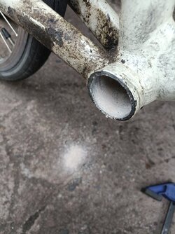

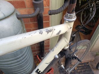

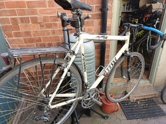

This belongs to a chap I know who does a lot of cycling but is not exactly hot on maintenance. I've just taken £300 off him for rebuilding his steel framed tourer from what looked like a bike that had been fished out of a canal, and he was so pleased with the result that he's commissioned me to restore this, which is his LeJog bike from a few years back
The trouble is, it's absolutely f***ed. Both wheel rims are worn out, the chain, chainrings and cassette are shot and everything with bearings needs replacing. None of that is insurmountable, but I suspect the frame is at the end of its life; I certainly wouldn't be happy riding it. You can see the pile of powder that came out of the BB shell when I took out the bottom bracket, and there are other places where it's corroded. In short, though this was a decent bike in its day and it clearly has some sentimental value for its owner, I think it might be the end of the road for it, although I don't have much experience with aluminium bikes. What's your opinion?
