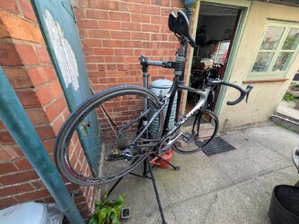

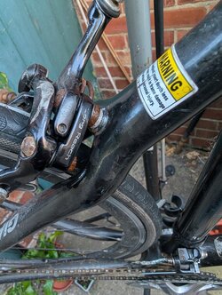

This is another one that's turned up in the workshop for "a service". I don't know how long it's been neglected - my guess is since about the early Palaeozoic - but while it looks ok at first glance, the brake caliper mounting bolts are seized absolutely solidly in the frame. I certainly can't get them out with an Allen key and I can't get a drill into them. Anyone got any tips, up to and including destroying the calipers (which are rough anyway)? It seems a shame to scrap the frame.

Plenty of penetrating oil and let it soak in for a day might do it. The spaces between the calipers and pivots look pretty corroded. Failing that a hacksaw might suffice.

I think the steel caliper bolt has chemically welded itself to the aluminium frame, in which case no amount of penetrating oil will shift it! I'll see what the owner wants to do before I do any more with it.

The hacksaw (or angle grinder) suggestion above would be the quickest, but it might be worth trying to unscrew the caliper itself rather than turning the recessed nut. Just hold the nut with a hex key if it starts to loosen.
I think getting the sleeve nut out is going to be the real issue.

Probably, but if the caliper could be removed an old bolt could be threaded in its place to tap the nut out.
First thing I tried. It's not moving! Once aluminium and steel chemically weld themselves together, they're together forever.

There’s an old internet formula 50-50 acetone + automatic transmission fluid, for ‘the ultimate’ penetrating fluid. My personal take on this is they don’t mix together and I feel it’s the low viscosity acetone that does the work. Working on other (non bike) aluminum threaded components, acetone (on its own) has freed parts that seemed impossible to separate. A few drops down the caliper hole might be worth a try. It might soften the paint though.

You could try either coke or diesel. TBH diesel usually works better if parts submerged. Used it various times on stuff that's been in situ 50yrs plus including dissimilar metals. When I've had issues with aluminium I'll reassemble it rightly or wrongly using an assembly paste. Either copperslip or assembly grease.
