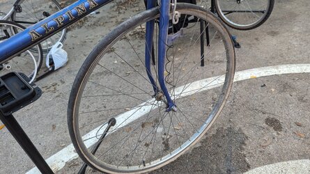

But first I wanted to figure out who are we dealing with here. Unfortunately, I was being stupid, so I didn't take a proper photo of the writing on the top tube. "Alpina" led me to a defunct South African manufacturer, who was either buying frames from Italy, or producing its own based on Italian design. I was unable to google up a photo of one just like I have here - with the shifters on the headset, the rear rack and the place for a dynamo. I can only imagine how a South African bicycle turned up in Tel-Aviv - I think it may have to do something with the fact, that Israel, itself under the Arab embargo at the time, was one of the few countries willing to trade with the Apartheid RSA.

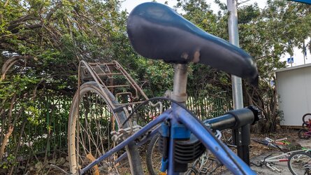

I haven't looked at it too close yet, but here's what I saw:
- Everything that can be stuck is stuck: the front wheel, the bottom bracket, so everything needs to be taken apart, degreased, regreased.
- Lots of rust everywhere, but fortunately not on the spokes (the stories I could tell!)
- The left pedal is screwed in sideways and needs to be replaced. I don't want plastic there, so I may end up ordering an aluminium one from China. I hope the crank arm is ok.
- The wheels are fine and true (which is a small wonder), but the tires are gone, so new ones will need to be sourced.
- The dynamo is long gone, but there's one - a completely unnecessary one - on one of the donor bikes (our term for bikes that are dead, but can still donate parts in order to save other bikes' lives). Interestingly, all the cables on this bike - both brakes and gears - are out in the open, as befits the era, but the wire from the dynamo to the rear light is routed through the frame. The headlamp is there, though I'm not sure whether it works, and the rear one is gone and will need to be replaced.
- Cables, noodles, casings, chain need to be replaced (and dork disc removed), that goes without saying.
- I think the freewheel is fine, which is a relief and a surprise too.
- The seat is serviceable, although I'd prefer something classier, if this comes through.

Alpina is indeed from South Africa and no, it isn't a catalogue bike or house brand. It was handmade in Johannesburg up to the late 1980s or early 1990s. I visited the factory after the family stopped making bikes and bought a few things from them, including a frame jig and some lugs. IIRC these were Cinelli BB lugs and Campag drop-outs. I later built al frame with those lugs on the jig that I got from them and I still have that frame today. The OPs bike is pre-1990s, after that Alpina followed the world-wide trend of going with Neon colours and then it all went tits-up for the local manufacturers, of which there were at least three I knew of - Alpina, DHC and Western Flyer/Raleigh (these two could have been one company, I can't remember).
Alpina would have had a few bikes in its line-up - that particular one looks like it has Suntour shifters.
The South African local manufacturer scene went quiet after that but Raleigh (not related to Raleigh UK) made a comeback in the early 2000s. Later on brands such as Pyga, Morewood and Momsen made their mark. I don't know if Pyga and Morewood are still going, but Momsen is.

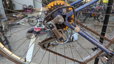

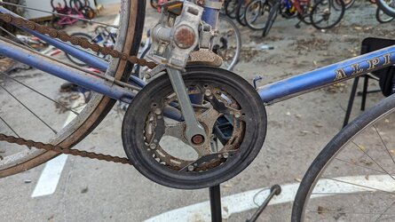

Let us move on. The front deraileur and the shifters are by a manufacturer called Sachs-Huret:
I found some info on it here.
The rear deraileur is yet another mystery. What is this writing, Martian?
I can't read it, can't even figure out which way to read it. Anyone?

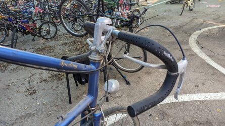

I took a photo of the model name - Sporting:
Google doesn't seem to know anything about Alpina Sporting, except this ad on a Hungarian site (the bike there is VERY similar to mine, down to the decals, minus the color). Here, though, someone was in a similar situation to mine, and according to the answers, Alpina Sporting was one of the brands used by a German manufacturer of entry level bikes, called Kynast. There are a few more that were sold over the years: this one, this one, and this one, however, none of those have the shifters on the head tube - but rather on the down tube, as opposed to mine:
Strange. Could it be an after market alteration?
Speaking of after market. The tires are gone, and those were Kenda 27 x 1 1/4, perhaps original, given how badly worn they were:
However, the handlerbar is covered not with a tape, as befits a road bike, but rather these strange grips:
Those look almost new. I mean, could those be original? I'm not sure.
