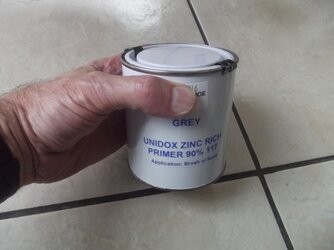

Galvanising paint has worked well for me - this stuff is great, but it takes about 10 minutes to get it stirred to a uniform consistency because the zinc is so heavy and settles to the bottom :laugh:
