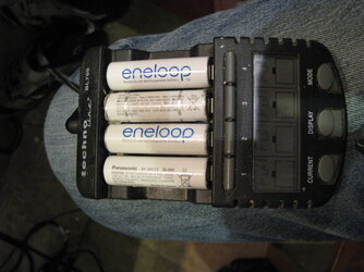

I would choose decent rechargeable batteries without a moment's hesitation. I bought four Eneloops about twelve years ago, together with a good charger and I've bought quite a few more ( both AA and AAA) since then to power the numerous battery gizmos at home. The original Eneloops are still going strong after many charges but they are starting to look a bit battered.

What's your thoughts/view on the charger pictured?

I've been very happy with it for more than a dozen years. It charges both AA and AAA. I think it's got a feature to recondition cells but I've never tried that. BTW, I have no idea what it cost's now but I think it was about twenty-something quid when I bought it, not cheap at the time. I think @ianrauk has one as well.

Not me dear chap. I have a 7dayShop charger. Which I've had for a good few years.

I have that same charger - excellent - I virtually always charge at the lowest level - learned my lesson with my first foray into charging - used non low self discharge batteries and a one-hour fast charger - fried the batteries pretty quickly.
edit - I see @classic33 asked about it- thoroughly recommended - available under several brandings, I think 7 day shop have sold it as well.
One version will also charge very fast if you need to in extremis - maybe when on tour. And one has a USB output at the back as well.
mine cost around £20 - better money spent than on a slice of a built-in battery light which would have been dumped by now.
