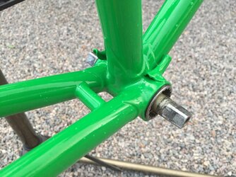

They were costly then, and remain so, but my Phil Wood square-taper bottom bracket feels like new after 46 years, without any maintenance whatsoever (they are sealed, lifetime bearings).
https://phil-wood-co.myshopify.com/collections/square-taper-bottom-brackets
All my powder-coater had to do was take it out, and put it back in again afterwards. It's good for another 46 years, I'd bet.

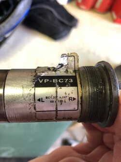

Ok so got my bottom bracket out,
it is 68 x 120. What tolerance Would I get away with if in Length? 117-122?
Halfords have a 117.5 or 122.5 in stock locally
T4tomo
does it say that on the label or have you just measured it? 118 & 122 are more common?
if it does actually say 120 on it either will work its only 1mm out either side to a 122. or you could get a 120mm from spa - ccoule of cheap options but not a UN300

Actual bracket
