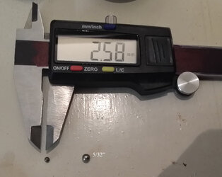

MontyVeda
this is what i found in my headset...
5/32" bearing on the right for scale... and a digital calliper, also for scale.
2.58mm, in imperial that appears to be slap bang in the middle of 3/32" and 7/64"
