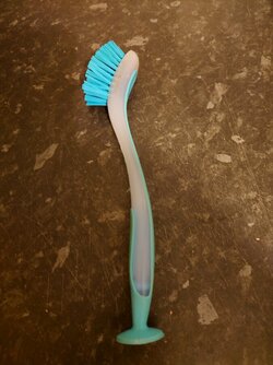

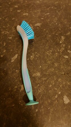

Some of the best things I have for bike cleaning are dish bushes.
IKEA sell a boring basic version for about 55p I usually. Grab a dozen or so when I'm being tortured in IKEA.
I keep three or so on the go for varying amounts of grubbyness. One for frame, one for muddy, one for oily bits like chain and cassette, chain stay or rear wheel if it's particularly grubby. The brushes move along the line as they become manky.
I just dunk the brush in a bucket of whatever foamy car soap solution is on offer and wash away. I might use a bit of screwfix degreaser in a squirty bottle for the oily greasy bits. And rinse.
Anyway, time cleaning the bike is time wasted that could have been spent riding the bike.

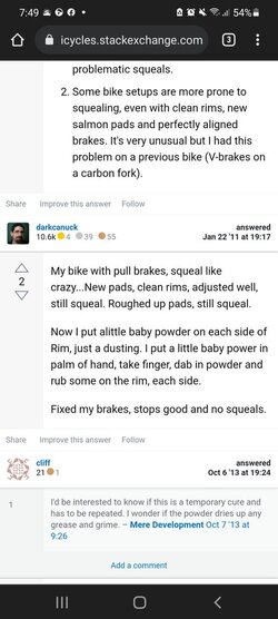

I have tried everything and the left brake pad still squeals. Its a new rim that has less than 200 miles on it and ive taken good care of it. Its a swytch wheel btw. Would baby powder work?
